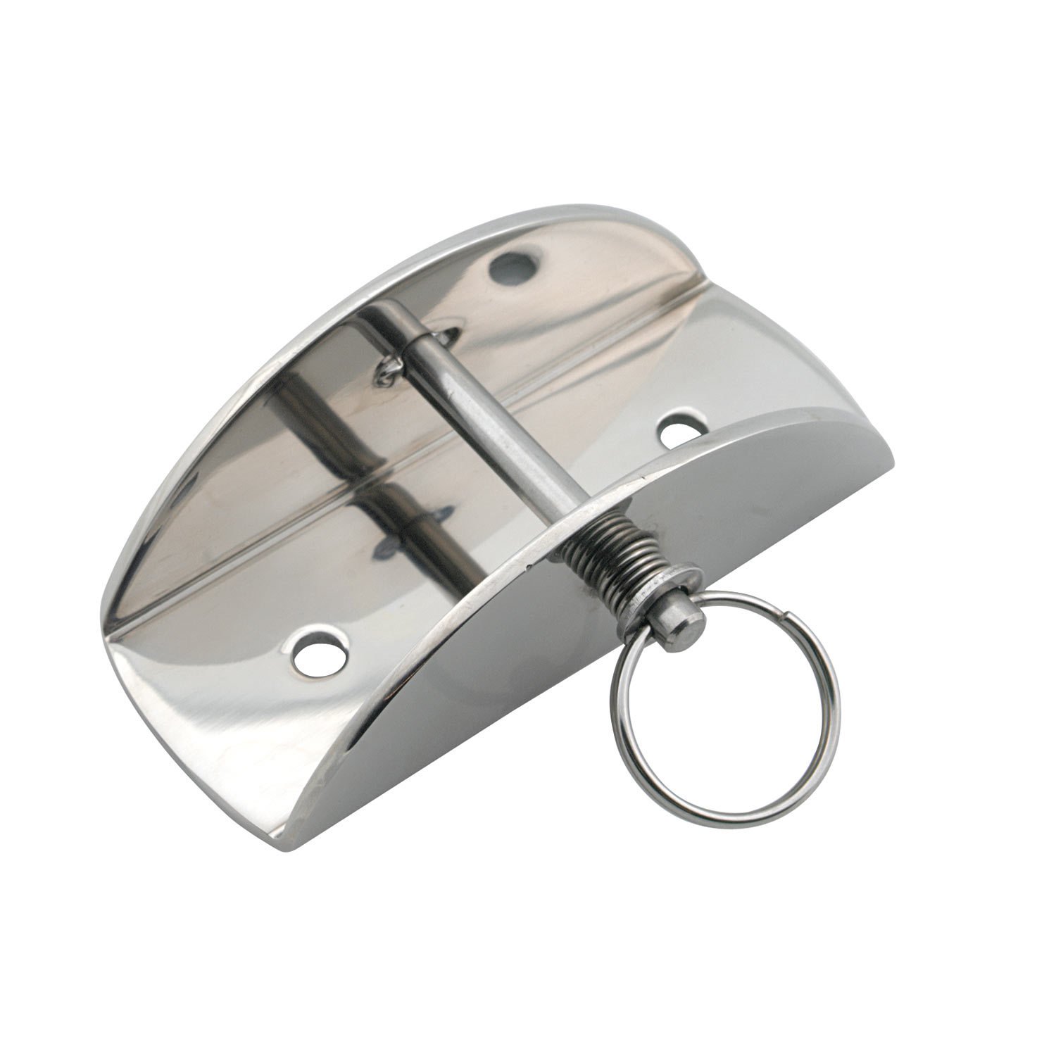

Good job on the windlass install. Look into the Lewmar anchor chain pin lock to secure anchor when traveling. It works great and eliminates any loose hardware from flopping around.

Got the same Lewmar windlass on my 228 but with a Lewmar plow type anchor. I love the windlass; was a big selling point on the boat and I anchor much more often since it's easy. I call it the marriage saver. That pin lock does look slick. May add that. Boat came with a vinyl-coated wire clip like KY shows. Definitely want the lock since it slowly loosens sometimes.
Good idea with the acorn nuts. I may do that. My rode hangs up sometimes on deploy and retreave. Love my plow anchor.
