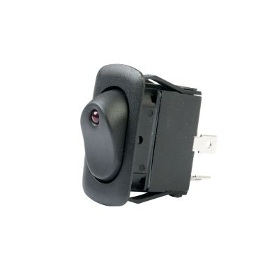

dainlaroche
Jan 29, 2013
55
These fit my ‘93 209
The breakers are different amperage depending on the circuit. They are easy to remove if you unscrew the panel and then the little rubber boot over the reset button. I searched using the info on the breaker and found these. Just match the amperage of the existing breaker. Also, I think the GW manuals have a wiring diagram that shows the amperage of each circuit.
Look at this on eBay
(2) E-T-A 1658-621-00-P10-10A Circuit Breaker 10A 240VAC 28VDC NEW!!! Free Ship
