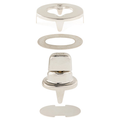

Unless they are underfoot I think that
"common sense" twist-lock fasteners are the most secure and there are versions with 2 screws. I replace a few snaps every year, but the common sense seems to last basically forever. the disadvantage is that you can only unsnap them from one side (which is pretty typical) they do not unsnap in the wind either.
