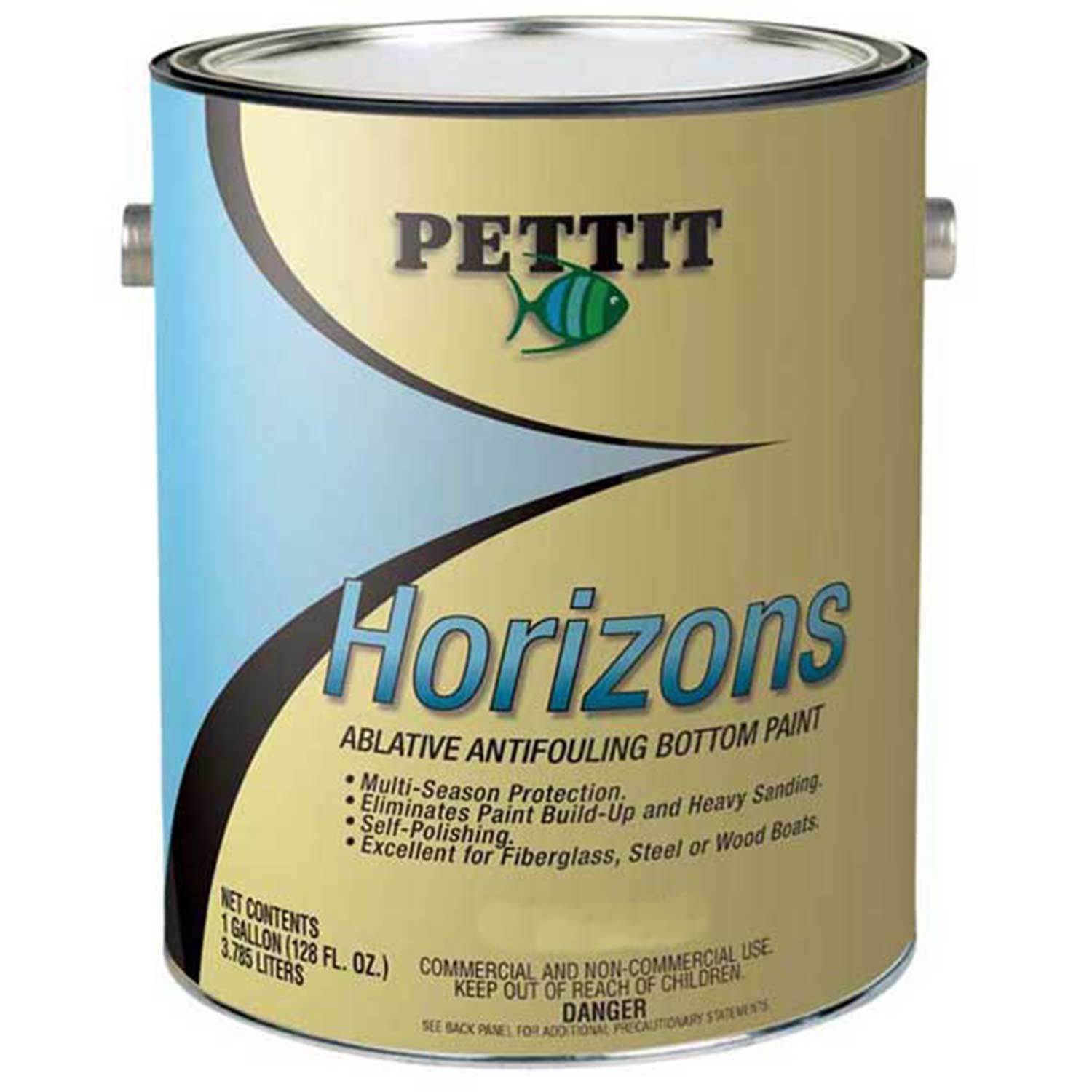

I lost a metal screw and needed protection on those metal trim tabs.
I used the product pictured below for bottom paint, but the West Marine spray can was for aluminum outdives/lower units.13875.jpeg

Thanks...see that as a popular one from the folks I talk to along with CPP.
I’m waiting for the Marina to call me to find out what they used on the hull as it worked well and why the bottom of the bracket was loaded with Barnacles.
