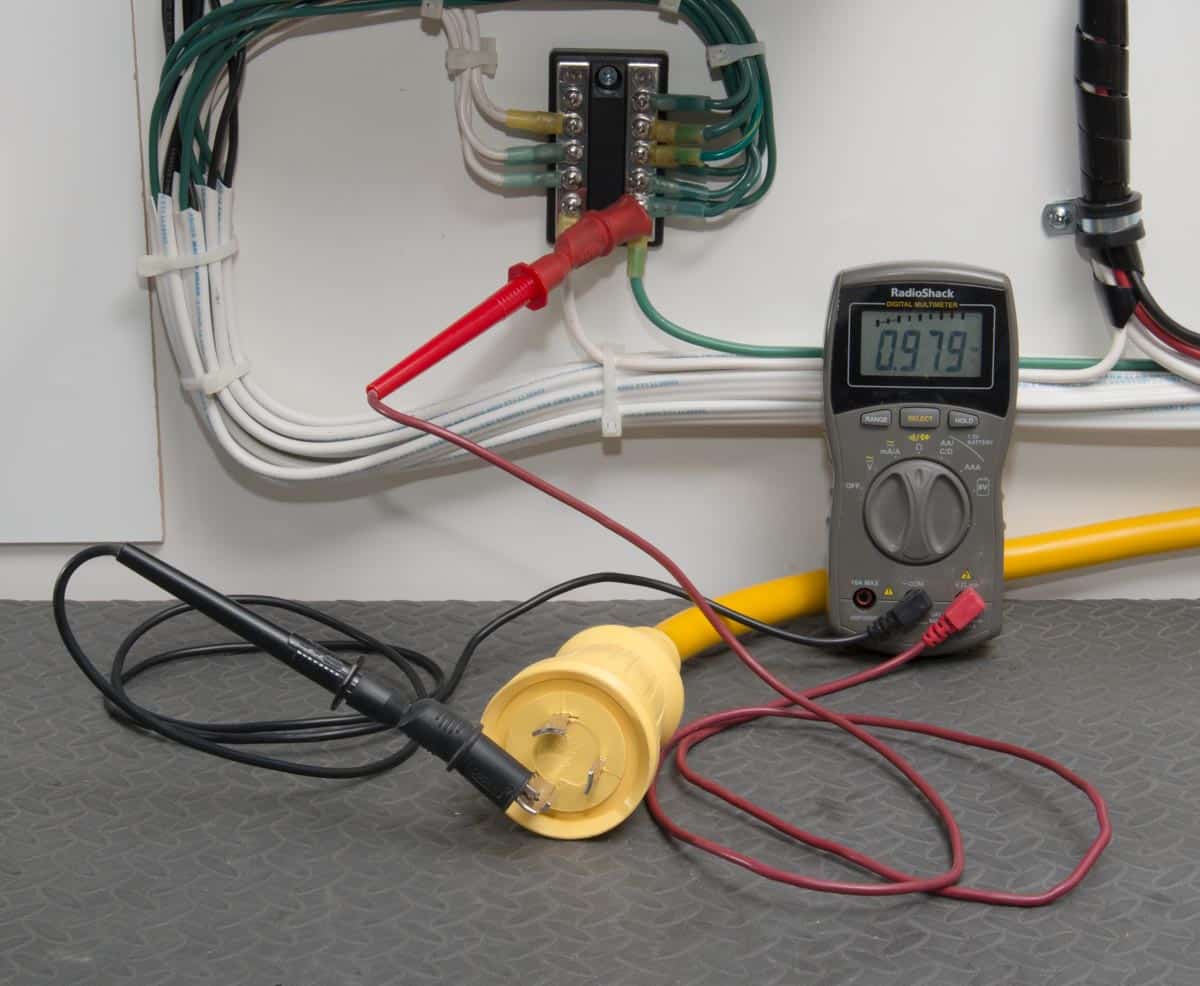

A galvanic isolator is a very good solution to reduce stray currents. They do go bad once in a while so checking should be part of your annual routine maintenance.
Here is an article from Boating Magazine that is very helpful
