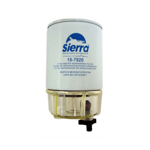

I installed the Sierra fuel-water separator in place of the standard Yamaha cans. This allows me to see if I'm accumulating water and to drain it without dropping the can. They spin on to your existing filter base so you can always go back to OEM anytime.
I have had at least two seasons where I had what I believe was phase separation immediately after adding stabilizer. I installed Sierra fuel filters with clear bowls to allow me to monitor water in the fuel and easily drain.
12/14/18 Added fuel stabilizer and ran boat to mix it up and get into the engines. Didn't get far. Boat ran like crap. Barely made it back to marina. This is what came out of filters. Small amount of something on the surface (maybe fuel) and the rest water? Nothing separates out overnight. After dumping this out I installed Sierra filters and used the remaining fuel without incident.

In the meantime while your trying to figure it out I would try a Sierra clear bowl filter with drain or drop the cans and dump them before and after every trip to see what is in them.
