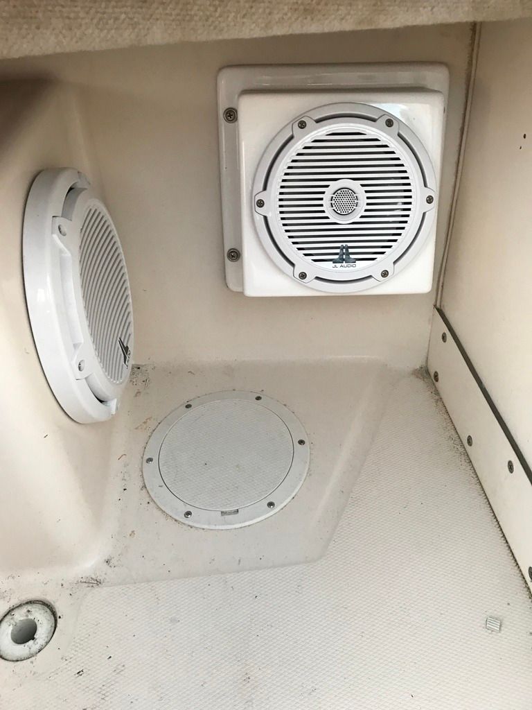

I haven't had a chance to get down to the boat and take photos yet. I will take a bunch of pics in the next few days and post them. I mounted the speakers in these boxes:
https://sportfishparts.com/products/fib ... audio-m770
I mounted the boxes in that small dead space between the cabin bulkhead and the seat pedestal bases/coolers. They are angled up towards the seats. The subwoofer is mounted in the passenger seat pedestal box/cooler.

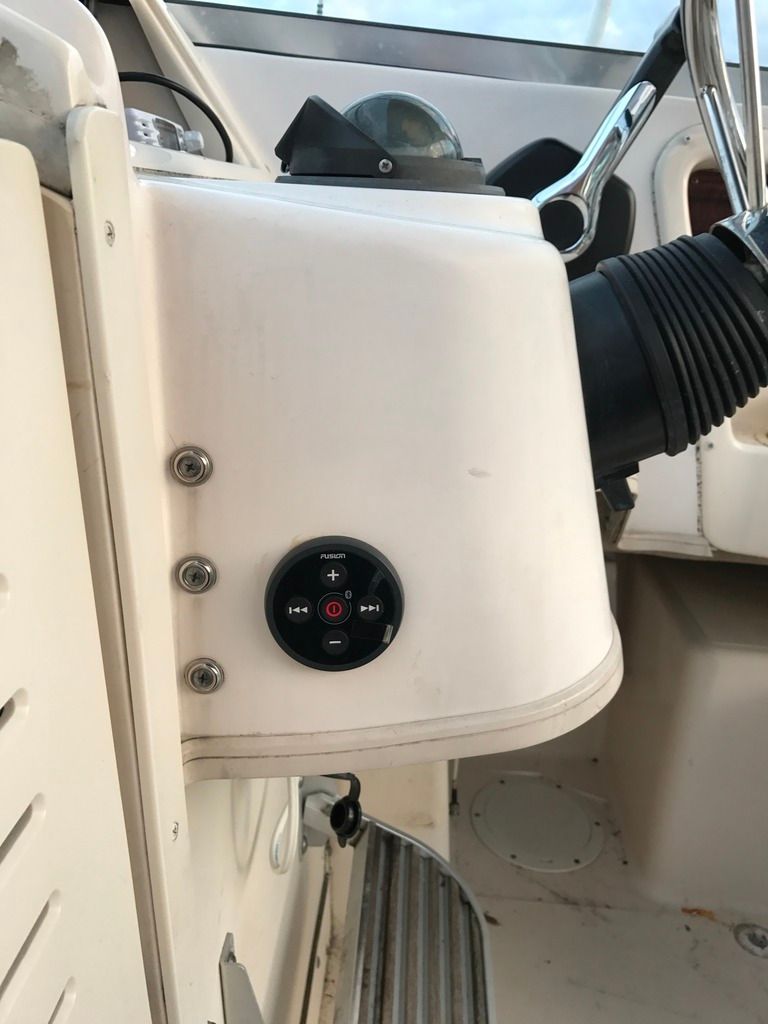

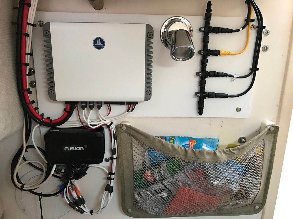

I posted in another thread on here but I'll copy and paste it here with a little more info. I bought a piece of starboard off of eBay and cut it down to size to mount against the bulkhead. I didn't want to drill a ton of holes into the boat so I mounted the board and then screwed all of the components into that piece of starboard. It worked out pretty well so far. Running the 4 gauge wire wound up being the easiest part of the install believe it or not. Ordering the wire from genuinedealz was worth every penny and the quality of the crimps is way better than I could have done myself. I still need to clean up some wiring and add a second set of speakers but this is what I have so far:
JL Audio MHD 900/5
2x JL Audio M770-TCW-CG-WH
1 JL Audio M10IB5-CG-WH
Fusion MS-BB100

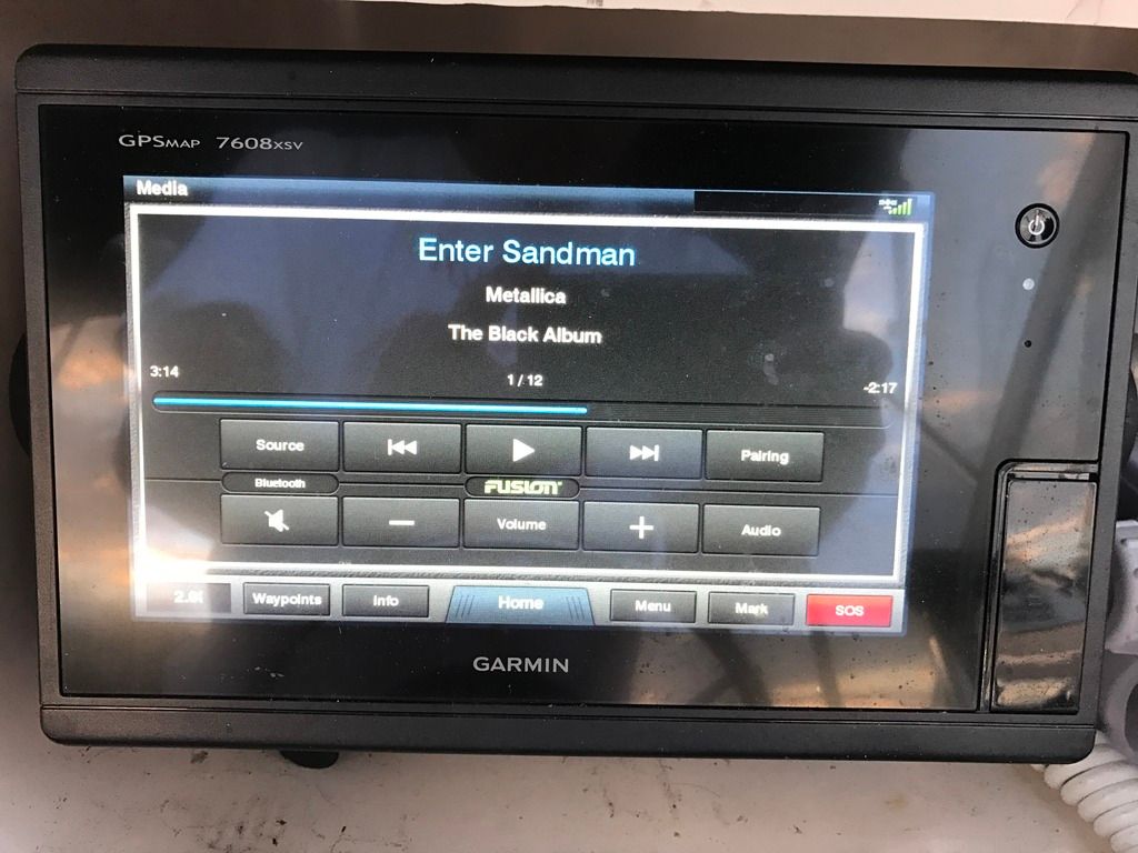

I really like the Fusion. I didn't want to deal with installing a full head unit inside the cuddy cabin but I also didn't want to have to control the head unit solely from the MFD. I took out the 12v receptacle on the helm and installed the remote in that spot. The remote is nice because you can raise/lower the volume or change a track without having to go thru several pages of menus on the Garmin. You can also control everything from the app on your phone.
