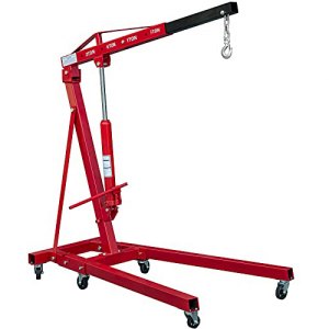

In terms of swapping engines, I think you’ll need a part like this, check harbor freight.

I picked up a foldable one ton crane from Harbor Frieght to swap my DT225's (470lb.s) on my Overnighter.
I had to raise the chain up to put the bolt thru the last link to get the hook as high as I could be then it did the swap like a champ.

I have used that crane for dozens of things since.

Yeah, definitely something I need to pick up. My neighbor has one too but I was thinking that I need two lifts - that's pretty clever though, Mike, the engine stand that you made. When the time comes, I am probably going to have a few questions, like already I am wondering if I will also need to swap the gauges with the motors or if I can leave them be and they will be compatible with the swap. The controllers too? That kind of stuff. :)
