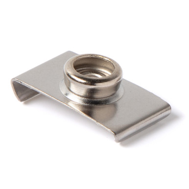

I have a few broken snaps for my enclosure, cushions. Most are an easy fix. Bought snap pliers and a large assortment of snaps. But the side snaps along the glass, are they standard snaps attached to the little slide brackets? Or do you purchase them already together? Can't seem to locate the slide snaps. How do i get them out? Squeeze?

Try Sailright.com . There are two widths for the brackets attached to the snap. Couldn’t find them at West Marine - wrong size.

They come in one piece. Look at the last photo to see how they are shaped, one end fits into the groove, and the other snaps in place. Use a plastic putty knife, or something that won't scratch your ws frame to pop that end up. Grady help desk cn tell you what size they used.

3/4" and 7/8" window clip snaps
