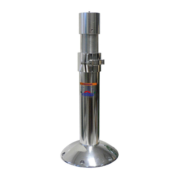

I was referring to these two pictures, which were installations on a Donzi and the second one on a Grady White, both seem like they're less than 12" tall, but if that's going to be double your height, then I guess it wouldn't work.
2,373
644
If that's the case and you need something that has an extremely low profile, then something like this with a height of 8.7" might be your only option.
