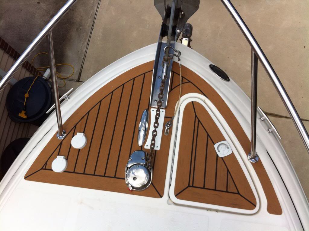

Waiting to hear clarification from Doc as to what he's really wondering about, but... I used to take a length of 3/4" black, heater hose and slit it lengthwise. It snaps right over the chain nicely. When you're using the windlass, simply snap the hose over your bowrail.
When I added a windlass to this boat, I also cut a piece of 1/4" starboard to help with chafing from rode slapping when going out.
Reactions: glacierbaze
no windlass, roller that does not roll. will post pic soon away from boat
Nice looking bow.. I like the cover solution.
Thanks, Fish. That boat originally only had a hawse pipe. When I added the windlass, the "hole" for the windlass would be slightly off center - so it meant filling the hole and then redrilling. Problem is, you would end up seeing some of the epoxy filler. So I either had to spend quite a few hours, at minimum (ontop of the multitude aready spent running wires, etc), replicating the non-skid, or spend about $200 on Plasdek to cover it up in 20 minutes. Well, you can see what I chose! I could have just made an adapter/cover plate out of starboard... but where would the fun be in doing that?
