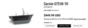

I'm waiting for Garmin to come out with a competing system to the Furuno Omni for the small boats (under 40'). The PS70 is pricey but would be OK if it really worked. I don't need the bottom mapping. I'm looking for fish. Some of the comment/reviews indicated it worked for them but I'm not convinced yet. I currently have a single Garmin GT512M-TH mounted on the centerline. Totally unhappy with the results. Images are like "ink blots" with no usable images. This is the best side scan image I ever got. SanPedro site in the Keys.

I guess I'm going to have to work at the GT-51M more this Winter.

My install does not involve a fairing block.
View attachment 37832 View attachment 37833
Isn't the black spacer between hull and transducer itself not a fairing block?
Not sure why you have this flat spacer, did you used the GT51M-TM and someone made this thin spacer?
Recent GT51M-TH come with a fairing block to cut to measure for adapting inclinations.
No it's part of the transducer. The faring block has a recess in it for the transducer. In the approved mounting locations above you can see the centerline one mounts directly to the hull.
The transducer is only 3" wide and my hull is reasonably flat there. I ground it out a little to flatten it and repaired before installing it.
Well, the new model looks different, mine looks like yours without the spacer, however the position you mounted it is perfectly fine, i have my B265LH there.
You need to change inclination to get the rear of the transducer up to correct hulls angle to get side-scan reading well.
How much you need to figure out as i wrote above, as your boat is on a trailer search in youtube for transducer coin to see how to measure and eventually correct transducer level.
To correct the level you need to buy or make a fairing block, or just leave it as it is and live with the bad reading.
That is what Garmin writes about thru-hull transducer mounting
In this case the transducers surface will be perpendicular as well and pointing straight down instead of forward.
Chris
The top 1/2" of the naked transducer is metal. The threaded stem and the mounting bolts are part of it. This sits in a recess in the fairing block which is not used in my case. The lower part is the plastic transducer encasement.Screenshot 2025-08-14 at 7.07.13 AM.png
I did cut my fairing block but did not use any of it. Garmin install instruction said mount to hull. I took a look at my hull. The waterline is snout 2" below the bottom paint. The keel drops down a few inches forward to aft. You can see from the transducer photo above the hull is clean. I don't think the angle is my problem. I'm going to talk to Garmin rep and a few installers next week at the MidAtlantic tournament in Cape May.
Please let us know what they told you as it would be important for many who wan't to install a thru-hull side-scan transducer.
