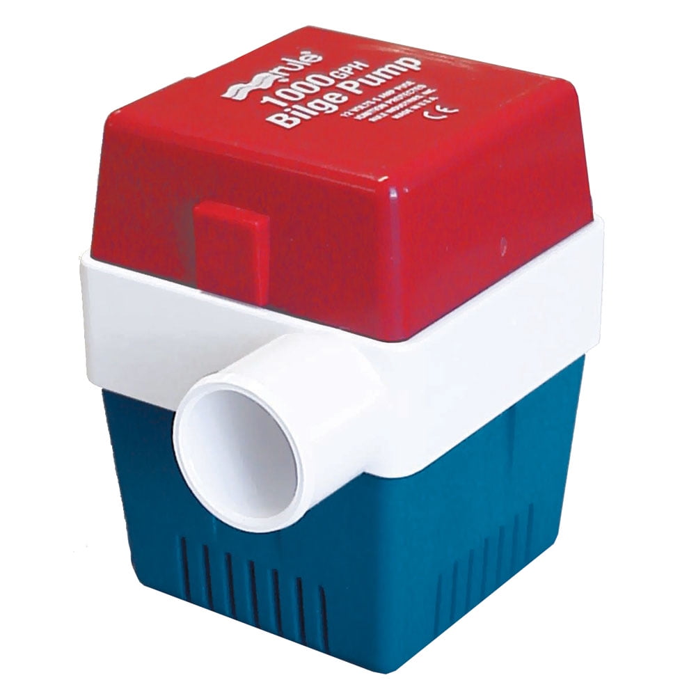

My bilge pump failed out on the water and nearly sunk the boat. thinking of replacing with two pumps on a switch as a backup. All is well (sump pump in the marina in the nick of time). I am not sure if there is another leak on the boat that caused this or just a week of rain including IDA when it burned out (I assume from the float switch getting stuck up with a wire that needs to be pulled up from the drain area)
1) What brand of bilge pump is this? from the picture in my bilge filth - it looks like a Rule 800gph and a rule-a-matic 14 amp float switch. Online I have seen a 20F and 20A and the claim that the 1000 is the new 800. I would just like to pop this in and replace the old one. I am sure it's ancient. I think 3/4?? these models evidently have different size connectors.
Bilge Pump: Does anyone know which is the appropriate modern model?
2) Float Switch: Also do I need a rule with an inline fuse? I have a marine grade one already, and hear that the rule has a non-marine grade fuse holder. not sure where that even goes. I've never replaced the pump.
aqualarm seems pretty cool too. also pricey Aqualarm Smart Bilge Pump Switch with Alarm (550065)
Rule-a-matic
would you use another switch with this? thinking of an all-electric switch like a whale or water-witch. I have seen people use a sure-ball, other options here. Not sure if there is a better option. I have had issues with things getting under the Rule-a-matic.

I run a Rule 2000 and a SureBail switch. The SureBail was original to my boat. I just put a new one in when I replaced my bilge pump.
Yes you should clean that bilge but I would focus on where is the water coming from that you almost lost the boat. Grady White hulls are extremely "dry" and minimal water gets into the bilge. Two pumps are ok but I would set one up as bilge and the other as a high water with alarm. All bilge pumps should have visible indicators on the dash next to the manual switches.

Couple of things. I realize its a tight spot but you should straighten out the bilge/live well wiring first. My guess is the there is something wrong with the wiring near the pump(s). Do your best to sort it out and get back to factory (manuals online at Grady White). The guy before you probably hacked something as a shortcut. I don't have a preference on automatic self-contained bilge pumps or separate components. Mine are all regular floats and separate pump.

I'm going for a USS Ultra Safety Systems Junior float switch. Expensive but I think worth it. It's mechanical but better than the Rule floating lever for blockage issues. looks like there are issues with solid state so not going with that as per your advice....
boat is dry as a bone back in the water. Used the USS ultra safety system for the rear bilge. The front bilge is wired wrong and has no auto (only manual) mode. I rewired to be automatic when switched on until I can run a new wire for auto mode
