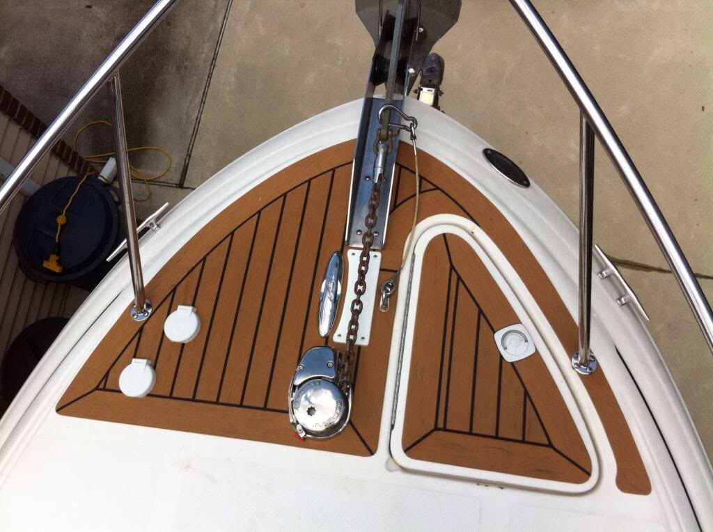

I had the same problem with the 92 228. I ended up vinyl wrapping them and they came out amazing.
can you share technique. I sanded and painted mine 4 years ago and are looking tired again
I bought a roll of shrink wrap vinyl, cut it size and briefly hit it w a heat gun. Came out amazing and it’s lasted at least 4 years. IMG_0852.jpeg63675736855__83E131FA-0680-4645-8E09-5B2D455F3AD8.jpegIMG_1034.jpegIMG_1033.jpeg
