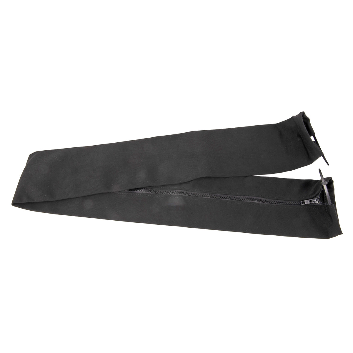

That job is a PIA. They make a fabric zippered one that works well until you are ready to do it for those that are waiting. Here is an example....
