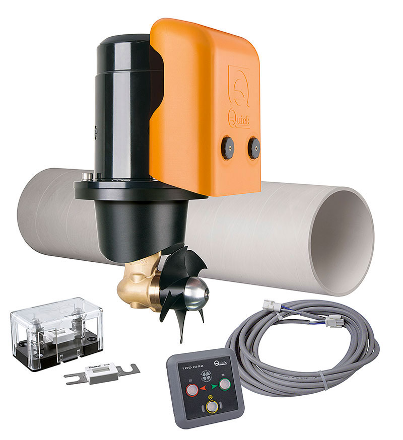

I have the same boat for over 4 years now and I find the low speed handling to be horrible. The wind catches the bow and it is all over. I've tried trimming the engine all the way up when maneuvering around the docks but it doesn't help. I have considered installing a bow thruster. An Italian company makes one that will fit. I have owned boats for 40 years and always considered myself a good boat handler. Not anymore. If I get into the slip without event it is almost a miracle. On the other hand the boat handles the ocean beautifully. Great riding boat. Very difficult to get it to pound. Other than a thruster I see no solution except to get rid of it. Btw, this is also the smallest boat I've ever owned.
