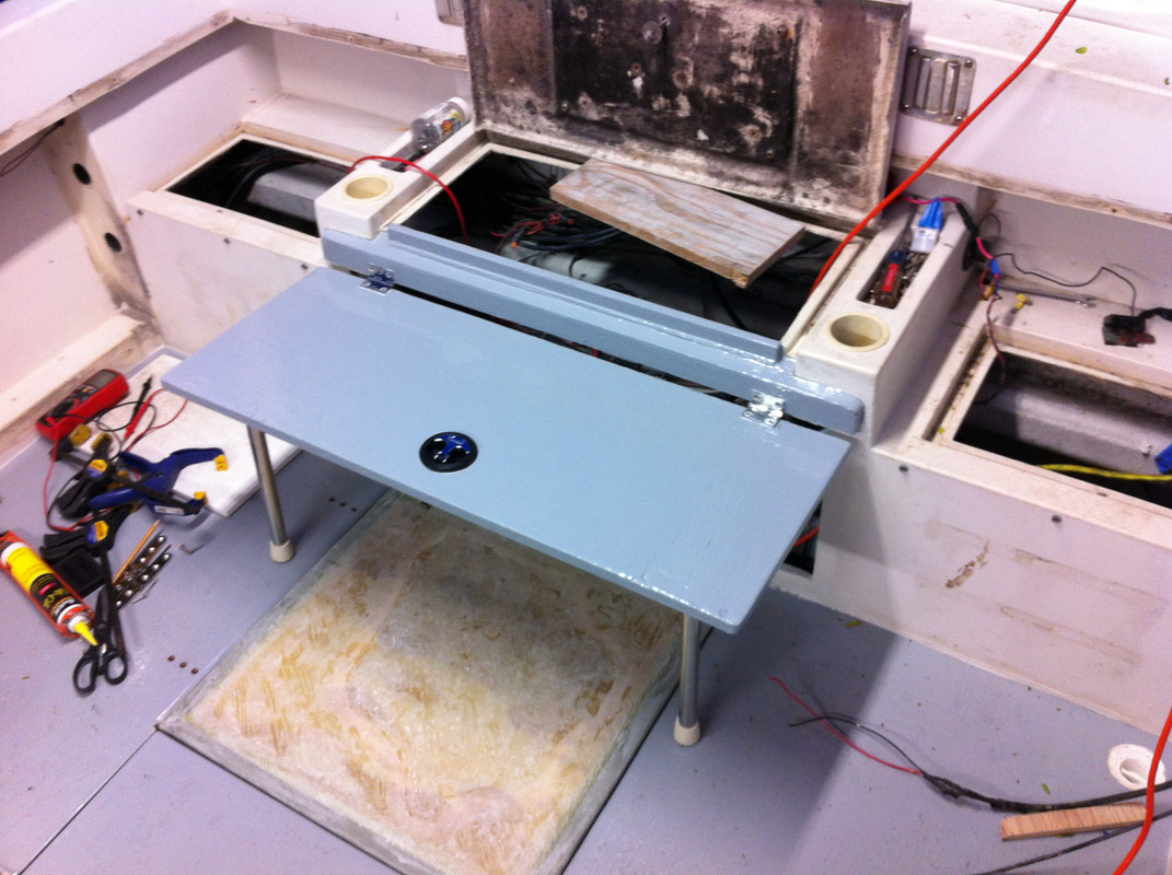

To better explain my situation...
My boat was originally a stern drive model and only had/has the forward 90-some gallon tank. If you look at the picture, you can see the "wider" cutout/hole where the sterndrive and the "dogbox" would have been. The perimeter of the that cutout had an exposed core - or atleast it was very poorly sealed (either from the factory or during the OB mod). Water migrated from that "engine hole" forward. The soft spot was only about a foot or two square, but once opened up, the soft wood covered a much larger area. Closer to the fish boxes, the wood was perfectly fine... but you know the 'ol saying "As long as you're in there" ;)
I rebuilt the floor "layout" somewhat - I built a new hatch to fit the new layout in the back that matched the width of the original hatch (the green, fiberglass L-channel is the start of the new hatch) and also built a flip-up table (simple/crude, but it works) that covers the vertical "hole". A little tip... to build the new hatch, I laid the L-channel in place and then just used a few small pieces of glass on the corners and dribbled some superglue on the glass to hold it in position while I took it back to the workbench so as not to loose the "shape".
Zowie!!! What a project!
It was actually a fun project. I did it over the winter -- see the heater in the first pic? I built a high frame for the shrink wrapping (basically, the whole back end of the boat was big box with plenty of headroom. I even installed shop lighting under the roof of the frame - that first picture was taken at night.
Rick, I hope those pics don't scare you - I posted them, primarily, so you can get a better understanding of how things are put together. Plus, everyone likes construction pics! :)
