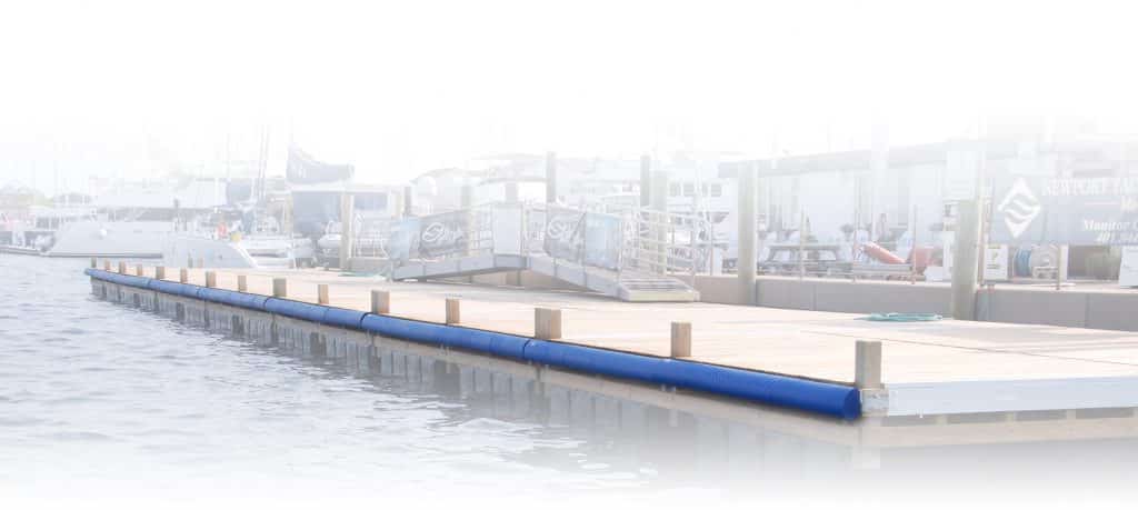

2. I would thoroughly inspect the dock and make sure there are no nails, screws or other protrusions that could scratch the boat. If there are things that you cant remove (like brackets), I would ask if the marina if you can cover them with rug/carpet.
3. I would invest in some 20x8 fenders and hang them horizontally on the dock. I would also use a fabric cover cover on them. In this case, I would likely spend the money and go with the Slammer Fender System (link below).
