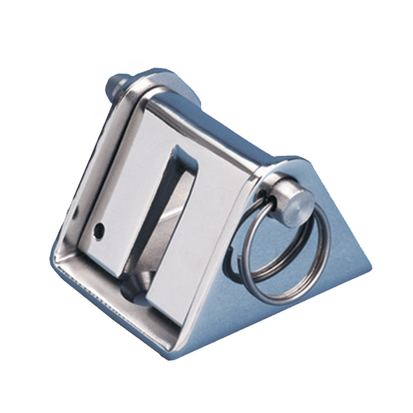

Get a simple "clevis hook" from your local hardware store for your size chain. 5/16"? Tie a 10'-ish length of line to it. Slide the hook onto the chain after the anchor roller... cleat the line to the boat... let out enough chain via the windlass to put the load on the clevis hook and line. Only do this when you're around - never overnight.
I don't think I would use the safety cable, because I don't think the eye bolt has a backing plate. I like DennisG01's suggestion. Alternatively, you could make a short cable/line with a clevis hook to go from the cleat to the chain.
All it takes is one boat wake or an errant wave to cause you an issue. I'd hate to see you end up with stress cracks around the eye-bolt for the safety cable.
How about anchoring in very shallow water where you don't reach the rope. I guess maybe just clip the safety chain back on...
Good question. It is advised by the windlass manufacturers to always 'tie' off the anchor, both when deployed and when fully retrieved. That way the bouncing of the boat doesn't put extra stress on the windlass. So to cover all possibilities, you need a cleat to tie off line and a cable with snap/carabiner to tie off chain
