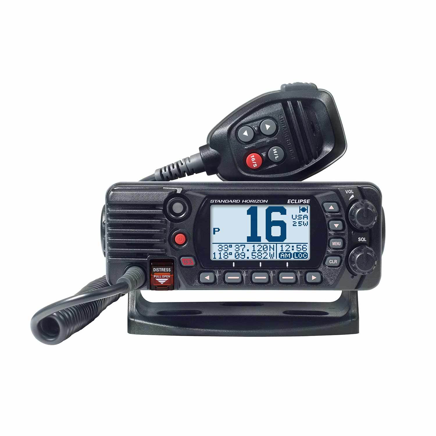

All- Who makes the best VHF within reason money wise $150-$200)-? Looking to swap out my 20 year old Icom on my 27ft Chase.
Have always has luck with Standard Horizon. I believe new needs to have internal or external GPS capability for DSC. I’d go with a model with internal GPS to simplify installation. Something like this:
You're the best! Thank you.
Just bought a standard horizon with GPS off of the GPSstore for $159 and there is a $50 rebate. Same one that's listed above.

Swapped my old icon for standard horizon gx1600, has dsc and linked to my garmin echomap, 180.00 at cabelos...love it.. my 91 seafarer still had loran c on it ,best of luck
Std Horizon GX1850GB. N2K connectivity and a built in GPS. Available for a couple bucks either side of $200 and a rebate is currently available through the end of September.

I think the current regulations are that radios have to have the DSC feature but do not have to have internal GPS. Personally, I prefer the radios with internal GPS, especially if you have older plotters that are a bit trickier to interface to. In addition, builtin GPS acts as a backup to the GPS in your plotter.

All VHF radio‘s sold since 2006 must have DSC capability, but are not required to have internal GPS. Internal is the way to go, but, if you want information such as a nearby mayday to show up on your chart plotter, you still must make the external connections using the small wires on your VHF and GPS cable. Very much worth the effort.
