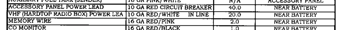

On my islander there are two power feeds from batteries to the helm/electronics box/overhead. The breakers/fuses are sized for short circuit protection of the wire runs and the device. The devices don't really draw that much power.
You can use the red/white hardtop power to power all your electronics.

I'm reasonably sure mine only has one, although there is a separate fuse panel in the hardtop. I can't imagine they would wire that directly to the battery with no manual disconnect. I want to say the only 3 pairs of leads I have wired directly to the battery (other than engine related) are my charging wires, inverter wires, and possibly tabs.
Look at the Owners Manual for the wire list. Look for the high amperage connections possibly with inline fuse. You have a newer model than my boat but it should be similar. These power wires will come out of the rigging tubes and connect to battery terminal or switches. There is a circuit breaker with a red button on it on my switch panel.
