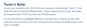

there is a tuner called NIZPRO that tunes them.
Personally, I wouldn't do it.
Has anyone tried to tune their F300 to get that extra 30-40hp? Was it worth it and did you have any issues after the tuning?
I spoke with a handful of mechanics whom offer the Nizpro tune. 60/40 split that I would see minimal benefits w/ 300 thus decided to pass. Sure I could save .5gph but I'm not a charter guy. Also only looking at couple mph on top end really. However I may do it should I install jack plate want to see how performance is improved with the prop running in cleaner water further off the transom. I may just be able to add prop with slightly more pitch and be happy.
I read on the Nizpro website that the tune for the 225 and 250 makes a significant difference, but on the 300 not so much other than a slight mpg improvement. Probably not worth the money on the 300.
