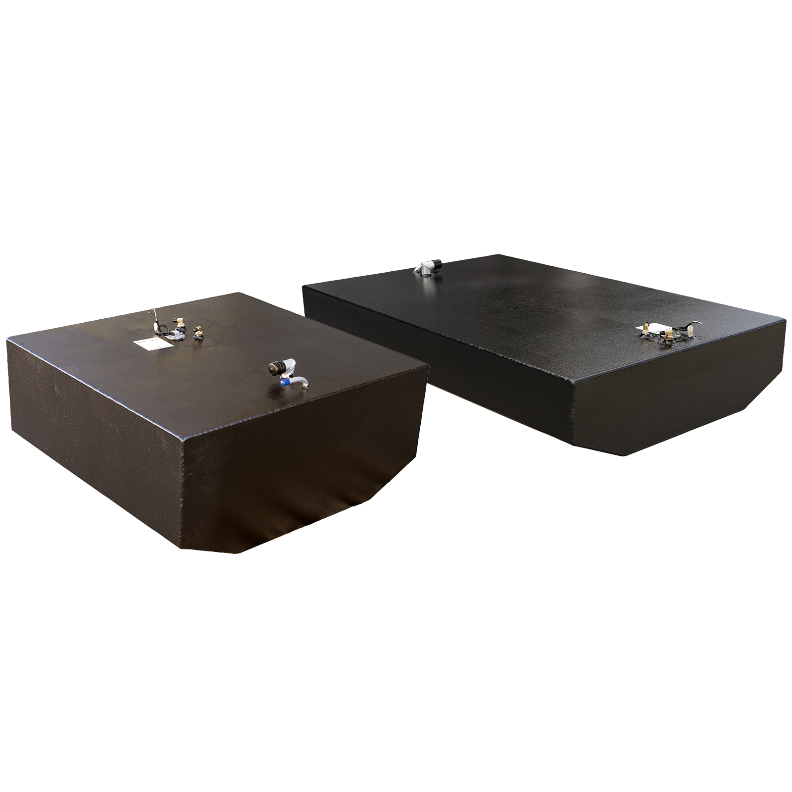

Well the tanks are in. Not much in the way of pictures but here’s a few. The sea trial/leak test found that the motors would only get to about 4500rpm’s. No leaks though! every filter has been changed on the motors so the injectors were pulled and sent out for cleaning. Hope to have them back next week. summer is almost over and I only have about an hour on this boat. Probably 100 hours of doing work on it. if I ever sell this boat, you Want to be the buyer. Oh yeah, replaced all bearings, hubs, rotors, and brakes on the trailer while in the shop.

Did they put any coating on the new tanks, or just put in as bare aluminum?
I’m not sure. I’ll take a look next week when I, hopefully, get her back
