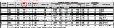

I eventually reconfigured to split the House from the start batteries. see https://www.greatgrady.com/threads/new-battery-config-for-265.25744/
