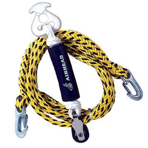

I second the fact that pylons are not meant for tubes. A simple bridle attached to the aft tow rings is what is recommended.
A bridle will work for towables or skis. Here is an example
