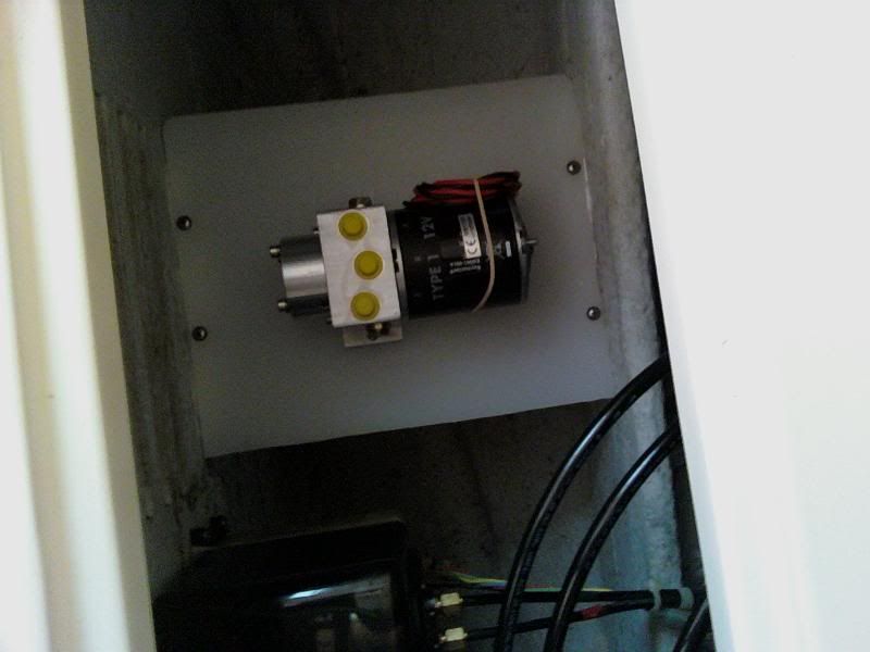

My AP11 computer is mounted on the rear wall of the cabin beside the stairs. No problems so far.
The pump unit is mounted were you had yours and i have just had to have the motor rebuilt due to rust......As Tom says it is a wet and difficult place to work on it.
The Compass is mounted in the same compartment (low and in the centre)on top of the drawers and away from the moisture.
