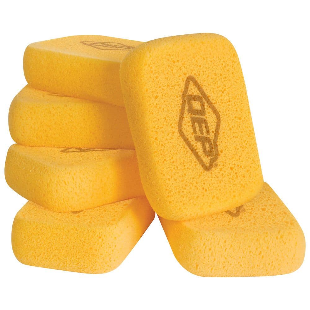

I know I'm bringing up an old point of discussion but I'm curious how those who run a strap across the boat at the stern gunnel to gunnel protect the rub rail where the strap passes over it and how you protect the hull from chafe where the strap rubs on it at the bottom.
Same way as you would with the two straps on the hooks. I use socks made out of soft cotton material. I have to say the straps that come with the boat from the dealer are weak as, I wouldn't use them they are totally useless junk made in bloody China . I use my own made from 50 mm rated strap and heavy duty hooks and ratchet. I also use over the gunnel strap as well and no the boat will not slide under it if the winch post wasn't there or it failed. I put the strap just forward of my downrigger bases . Another safety feature I have a chain from the bow hook going down on the trailer draw bar I do it tight with a turn buckle, this will not let the boat move forward if the post failed. You can also re-enforce the post with a prop bar welded on the post and U bolt it on the trailer draw bar. I don't have that on my current trailer as I have the chain but I had it on a previous trailer .
I have seen so many boats come off trailers you can never be too careful .
