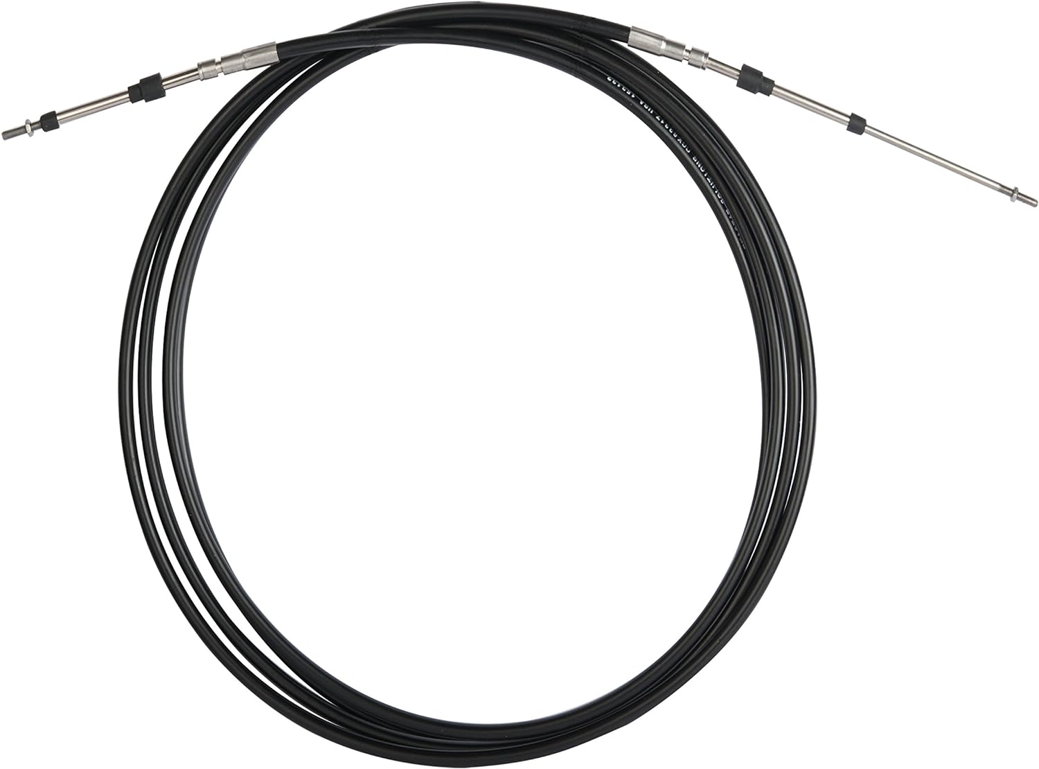

Tore control box open looks like it’s a cable issue. Cables disconnected from motor and control box are really hard to move. Any zip ties I need to be made aware of before trying to pull them through on a 2003 228?

The cables don't last forever. Plan on replacing all four. They are only $70 or so each and if you have pulled the binnacle you are most of the way there. You need to determine the length though. You need to look at the cable ends but never sure which ends are marked. Mine were 2' different side-to-side. Don't make a project out of it -get the lengths off the cables -done right done once.

When you replace them, don't go cheap. Get the high quality ones, way ahead in the long run.

I am not sure what your problem is but if you are going to replace the cables, two pieces of advice. When you pull the old cables out. tie a small diameter rope to the loose ends so that after the cables ate pulled out, you have a drag line to pull the new ones. The cable ends are fatter at the helm so usually you pull out from the helm and reinstall from the helm, pulling from aft.(In reality you will probably have to pull from under the deck to the stern and then push the control ends up through the helm area.
The most important thing is to note and take pictures of the internals of the control box when you open it and also keep in mind that some bushings can fall out. There are several options when connecting the cables at the box and only one is correct.

Generally yes and sometimes the rigging tubes are packed. Pulling 4 at once may be tough. The drag line that is pulled when you pull out the old cables should also be pulled back when you pull new cables so that there is always a rope available for the next pull. When done leave a rope in place for the next time you have to pull say a transducer cable. You will thanks yourself.
With respect to pulling more than one cable at a time, one trick is not to tape the end together at the same point. One cable end should be secured to the other cable about a foot or so from the first cable's end. That minimized the thickness of the assembly. Using a cable pulling lubricant can also help in tight situations. In a pinch, soapy water will do.

Pull them one-at-a-time!
The way I did it was I threaded a plastic bushing I got from Lowes, screwed the cables together and pulled the new ones thru. Worked well but it does create a long stiff section where the cables join. You need to be careful to pull as straight as possible.
The old cables will be marked with the length on one end. Don't guess on length - find out what is in there now and get the right lengths. My parts supplier does lots or repowers. What he doesn't have in stock he can get the next day. Nice if you don't have to deal with shipping.

Well after multiple orders and cancelations I found out that the manufacture in Japan has the Yamaha II cables on back order. Found the Seastar extreme at west marine I guess that will be my new cables. Pulled one cable out last night there are some zip ties near the stern but pretty easy to get to. Will pick these up today and hopefully be back on the water next week.

Don't guess on the cable length. The cables are marked on one end - no telling which end.
9,170
The Seastar Extreme would be my preference

Think I found the problem. Oh well old cables are out and new ones are in. Any suggestions on how to cram all the stuff in the rubber boot back in it. Seems to be a PIA so far.
9,170
The trick to cramming things back in is ( maybe too late) to take a picture or make a sketch of what was in what space in the bushing before pulling out the cables:)
Otherwise, just keep trying different arrangements. I had a case where I just cut some of the spacing nibs to make a bigger space. I couldn't get all the cables and hoses back in. In some cases, when new fuel lines are installed, the outside diameter of the new fuel lines are larger than the orig.

Ok all is back together I have forward and reverse in my drive way and feel like the throttle is close to where it needs to be. I won't know that until it's in the water and tested. Thanks for the input. Not sure what a cable replacement would have cost me but I love doing my on repairs as much as possible. I did realize at 64 I can't squeeze into the bilge like I used to but I can still try. Found zip ties on the rubber boot to hold everything in place can be your friend. If anyone has any suggestions on correcting the throttle before putting it in the water please chime in
