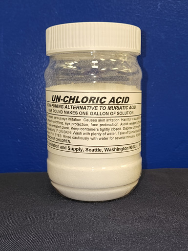

c) For heavy sludge/calcium, consider their Un-Chloric Acid treatment. Follow their instructions. This can make nasty tanks and lines "like new":
marinesan.com

Unchloric Acid
chemical, unchloric acid, holding tank, calcification, toilet, marine, break down, UNCHLORIC
