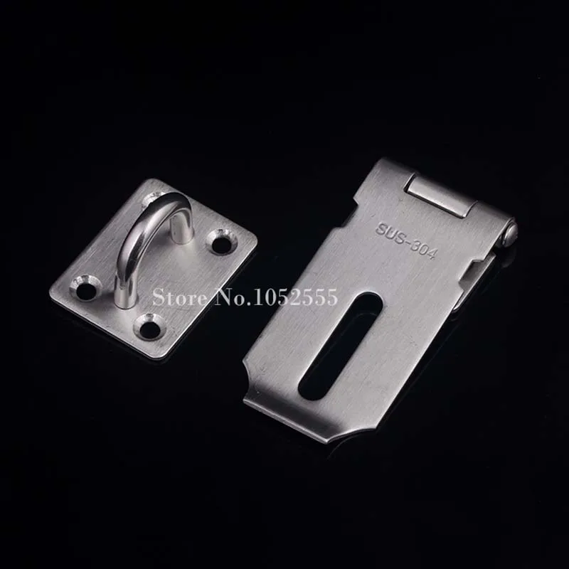

Grady used an odd size for the fuel fill. I found that out when I went to replace all my lines. I ended up cleaning up and reusing the original unit.
I might suggest mounting a Stainless hasp. Use a non swivel loop end. The caps are nylon plastic so drill the four bolt holes through the cap to attach the loop end with stainless bolts and nylon stop nuts(that won't back out). When the hasp is closed over it you can secure it with a padlock. A side benefit is the loop would make it easier to remove the cap when you want to fuel up.
It could be pried up but it might slow an unprepared thief enough that he'd pass your boat up for an easier target.
It's a little redneck but it's an idea and at least get the wheels turning to come up with a clever solution.
