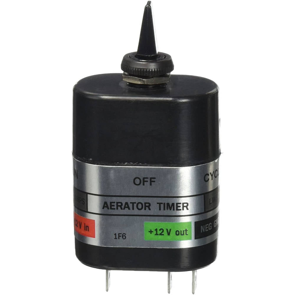

Depending on the livewell size, pump capacity and species of bait stored in it, running the pump 100% of the time may not be optimal for bait life. There are timers that can be fitted that can be set to provide the correct aeration rate as well as reduce potential stress.
Here is a simple, fairly cheap example

I don't have much use for a timer. Flow isn't too bad in small bail well for the shrimp. For the gogs and bally it doesn't seem to be a problem.
I did make a timer for my 29' Luhrs though. If you backed up hard the prop wash would air lock the bait pump. You wouldn't know it happened until the gogs started to go belly up. Expensive problem and cheap fix.
