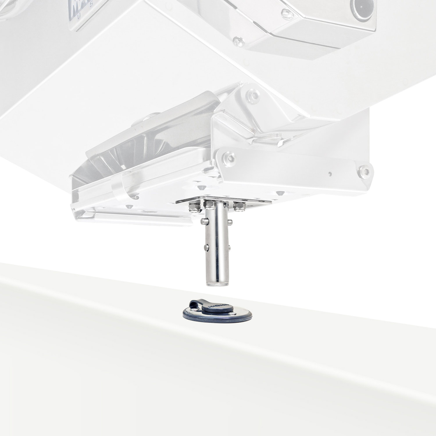

Yes, remove the screw and pull up on the entire seat back. There are two posts that have spring loaded balls that hold them in. Sometimes they may be a little sticky to get up and out. Lube them when you put them back in. Makes it easy to clean around.

I am not positive but I *THINK* the posts look like these, where you really gotta squeeze your hand in there and feel around for the release, then wiggle back and forth as you pull upwards. Pushing inward on the exposed nub pushes the hidden nub (which is mated to a hole in the side of the socket) inward as well.
After thinking on this for a while I realize that maybe mine were so out of whack the one time I removed them that I could feel the nub that was supposed to be in the socket. In either case, persistence will remove. And yes, undo the screw holding them to the sides first. :)
