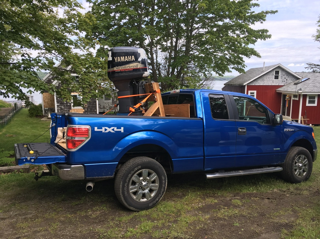

I use a steering lock if am leaving the motor tilted up for an extended period of time. In the past I did not on previous boats. When I repowered my Grady 205, the Grady dealer mechanic that did the install warned me that on this style transom with the six cylinder 225, there is a limitation. In all different amounts of trim while running the boat there is no possibility of the motor cowling contacting the fiberglass. However, if you tilt the motor all the way up, like you see some people do, and let the motor drift over to the stops, the cowling will hit the corner of the transom cutout. For that reason I purchased stops. On the matter of the MyWedge, I am a believer but beware as some of the older Yamahas had the grease fitting so close to the starboard ram that the fitting can be damaged and so it is recommended that the port side ram is recommended for the use of the MWedge. I know my old 150hp Yamaha 4strokes were like that but my new 4.2L has no clearance problems.image.jpgjimage.jpgimage.jpgimage.jpg

When trailering, though, the best thing you can do is to keep the engine totally vertical :)
Reactions: Halfhitch

Oh... FYI, that's my spare engine that went 500 miles from PA to ME this Summer.
Given your history of ingenuity, no doubt there is a sprocket where the prop was and a hole in the bed with a motorcycle chain running down to a sprocket on the driveline.
