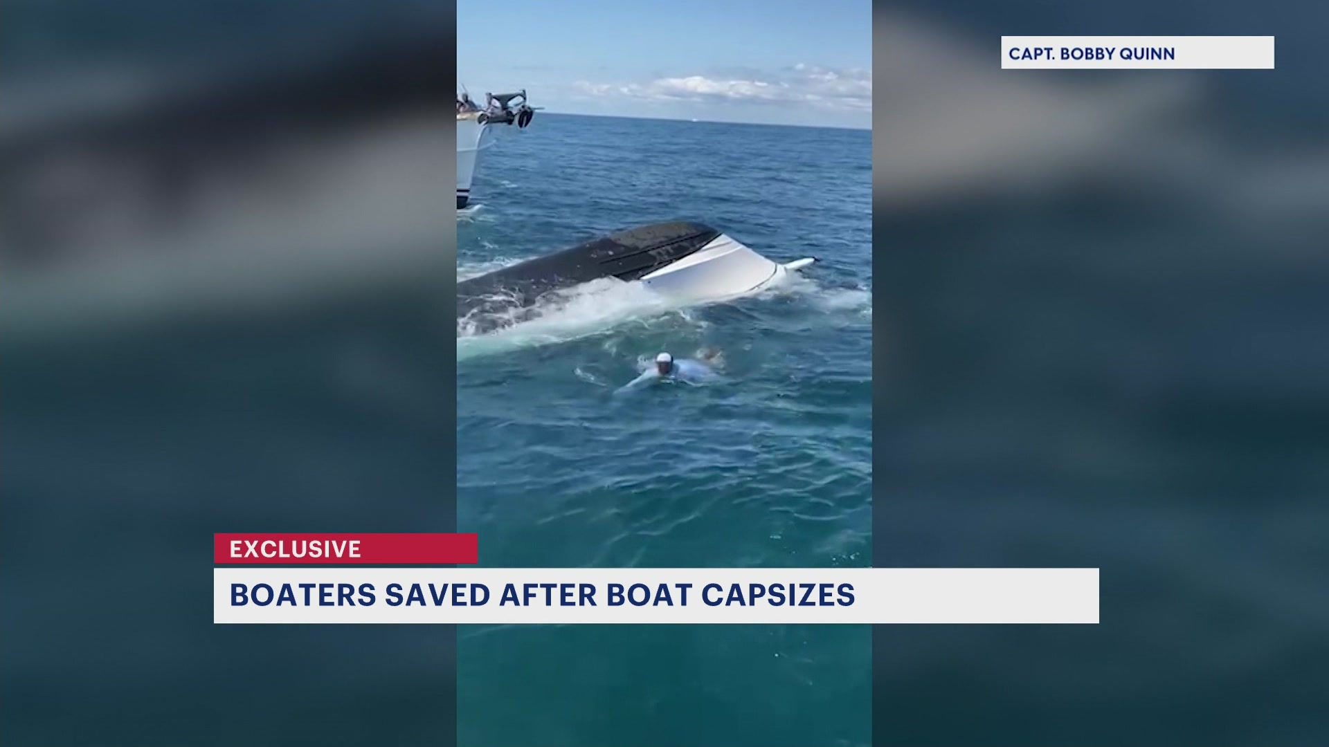

Does anybody have any information on the Grady 265 that capsized this week off of Belmar NJ? I hope everyone is okay.

It's hard to tell via the pictures/video if this boat is a Grady White but it does look like it could possibly be the story you're talking about...

It was a 27' Grady..sbaw the link in the news, everyone was rescued by a nearby party boat

Mustang, thats the same one. Somewhere on my feed I saw the boat was recovered the next day close to Barnegat Light. It showed a picture and it was clearly a 265. We just wondering if anyone had any details as to what happened, ie cockpit drain hoses failed etc. I'm glad everyone is okay.

So what is the buoyancy of the boat waterlogged? It obviously flipped and the seas were not that high so something else must have contributed to the capsizing. Or then the boat does not sink but does not offer "comfort " when upside down, noting to hold onto as only the bow was visible.
We don't know how long it took and what caused it all. So just waiting for more info as it and if it becomes available.
Good all ended well anyway.

Great video. Captain of rescue vessel was eye witness "I looked, their boat, Jesus' boat, literally started sinking at the stern, and literally two seconds later, it just flipped right over, and all these guys went right in the water."
After they were rescued the Captain gave them fishing rods and fished the rest of the day. And they caught fish!
Not clear what type boat it was or why it was taking water on. Could not find any information on salvage.

definitely a 265. Don't recognize the boat or the guys onboard.
Its not a trailer boat..he didn't forget the plug.
lots of things could flood a boat.
The original scupper hoses were scary on mine.
There are four 6" popout pie holes in the motorwell.
The livewell thruhull & pump can leak..or snap off and really leak
The washdown thru hull & pump hoses can leak.
The head intake and outlet hoses and thruhulls
add to that one or both bilge pumps not working....
I don't like that it turtled so fast. 265 has foam outside of the stringers and a really heavy hardtop.
