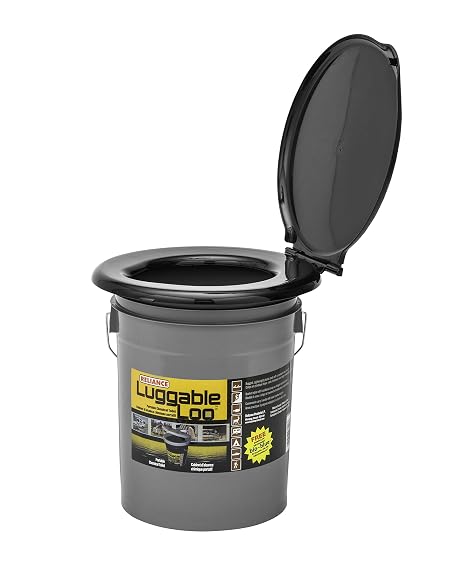

When nature calls in an emergency that person goes up front and uses towels or blanket across the split window and windshield for privacy, it works, not great but doable.
I was considering that or a transom rig with a shower curtain clipped between two rods (in holders). Hopefully a 5 gallon bucket will fit in the passenger console or one of the lockers or wells?
