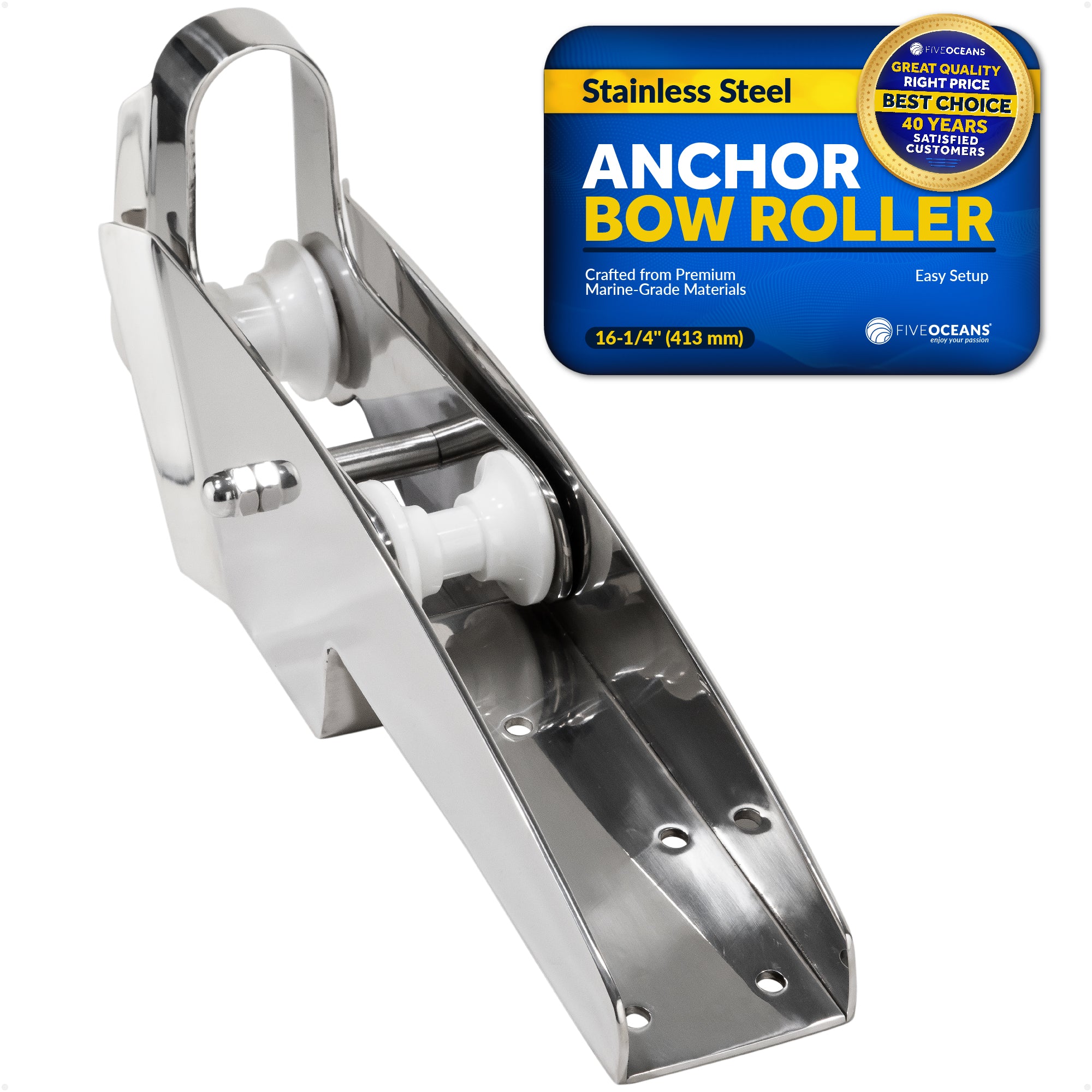

Last summer I installed the Five Oceans pivoting anchor roller. Ignore the unfinished glass work - can't seem to get a glass guy to do small jobs. Roller works great.

Pulpit... spray the thing with some slightly off-white Rustoleum. It'll be good enough that you may find you forget about it! When/if you do get a gel guy, it'll sand off easy/quickly enough.

When you changed the roller, did you have the groove where the stock roller fits on a lot of GW's, and if so, did you fill it or just go over it?

I had the groove but it was narrow. I cut out the pulpit to recess the front of the roller and filled the groove when all the raw edges were finished.

Hookup,,,, you have any in progress install pics of the roller system? Curious as to your mods to the pulpit. Looks interesting.
