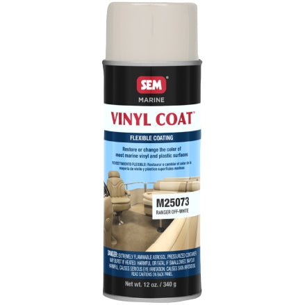

Used this product plus the cleaner they sell for prep and it turned out very good. Not an exact color match but very close, looks way better than it did before and much better than the sock mod. Cleaned both arm rests very good, lightly sanded them, then sprayed a few coats of the vinyl paint and let dry.
picking up some today ... how does it hold up
