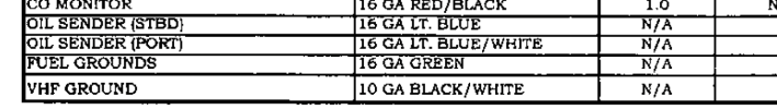

The Grady wire bundle used green wire and had the Fuel Fill and tank grounds come together in one ring terminal on a Negative battery post. (all neg battery posts are tied together so it does matter which one)

Thank you everyone! I will run 8 gauge GREEN wire and bond the tanks and fill studs and run to the negative battery terminal.
You guys are hilarious! Thank you for the heads up! I’ll go with smaller wire
