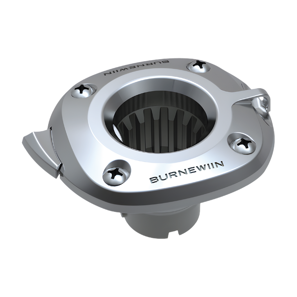

I have a completely different boat as well as setup, of which I also don't do tuna fishing and mostly troll for salmon around where I live in the Seattle/Puget Sound area. That being said, I installed some Burnewiin brand downrigger mounts in place of where the original rear GW mounts were. They look similar to the stock mounts but on steroids and they're a gimbal mount so you can add just about any attachment that you want to them. Not saying you should copy my layout or anything as the boats/fishing styles are completely different, but I'm not sure if there's a company out there that beats Burnewiin mounts in terms of their quality. They're definitely not cheap though, especially when you add multiple mounts and different kinds of mounts together. I bought these GM650's from them, they're a stainless steel mount and look fantastic.
